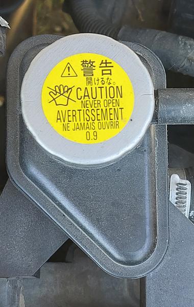

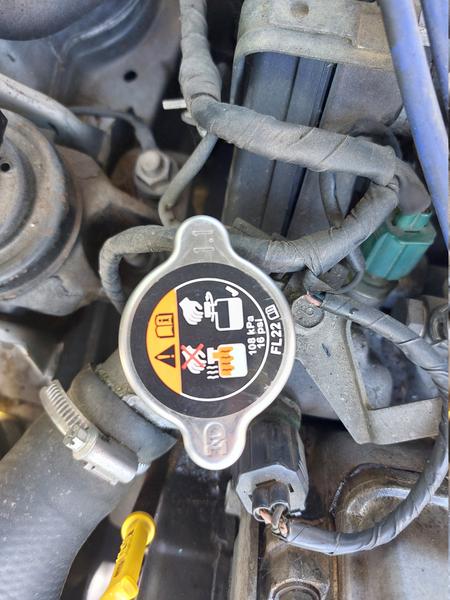

I also noticed a slight leak of coolant under this cap.
Does that cap hold the pressure at 1.1? Since the expansion tank on the radiator says 0.9?

Beitragvon Kampfkuchen » Fr 22. Mai 2026, 17:51
Ah I forgot the question about the Filler-Cap.
There are two caps, one normal cap and one with a spring for overpressure. If you stand in front of your car, the left is the normal filler cap. The right one, on the cooler unit, MUST have a spring. There is a hose to a coolant container, in the left fender (there is also a filler cap). If the pressure is too high, it pushes coolant into this container and in case of underpressure it sucks it from there (most likely a pressure equalization tank, but for a closed system).
If you want to bleed the engine, there are mystic ways and everybody has their own workflow, I think :D
I fill the container with 1l of coolant, then the one on the cooler to the edge. Close it, fill the left one and squeeze the hose while filling. After this I run the engine and fill again (cold engine, while running). If the level doesn't go down, I close it and drive. After some time I refill.
Worst case is air in the throttle body, because the idle valve cannot work properly. You will realize this, if your idle speed is inconsistent. If it is like it has to be, it's most likely a success.

Beitragvon JokeCro » Sa 23. Mai 2026, 15:08
New Filler cap 1.1 bar with spring
They say the filler cap should be 1.1 bar and 0.9 bar on the expansion tank on the radiator, for normal coolant circulation.

Beitragvon Kampfkuchen » Sa 23. Mai 2026, 16:33
I don't think this makes any sense.
You have a 0.9 filler cap and a 1.1 filler cap. First: original is only the 0.9, the second doesn't has a spring. Second: how would you get to 1.1? At 0.9 the expansion-tank valve opens and there is no room for 1.1bar so this filler cap never opens. Only if the 0.9 has a malfuncion, but I think this is a bit paranoid. I mean, it is not bad to have a emergency-valve, but I think this never opens.
Beiträge: 3672
