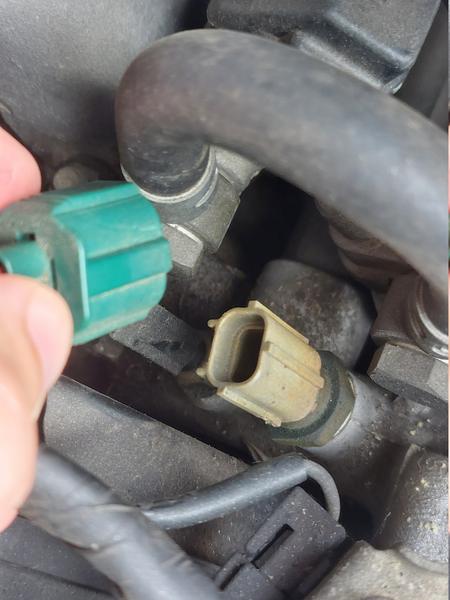

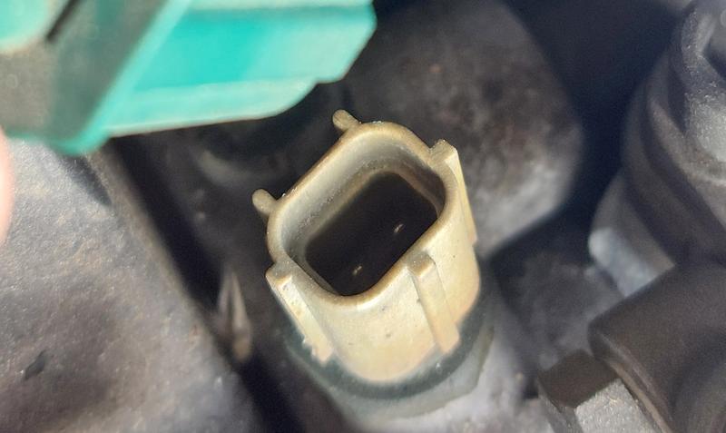

There are two more sensors in that location, one with one wire (for the needle on the dashboard) and another with two wires.
What is that second sensor actually for?
I put a new one on the third one.

Yes, there are actually 3 different sensors in that location, one with a single wire (probably for the needle on the dashboard) and two sensors on each side near the coolant cap.
I replaced one, the green ECT one.

Is this other sensor that hasn't been replaced a thermal switch or something?

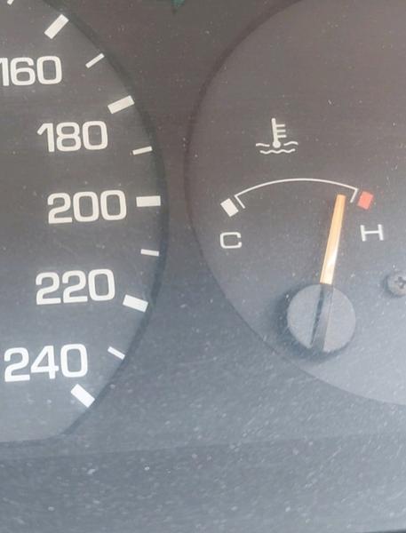

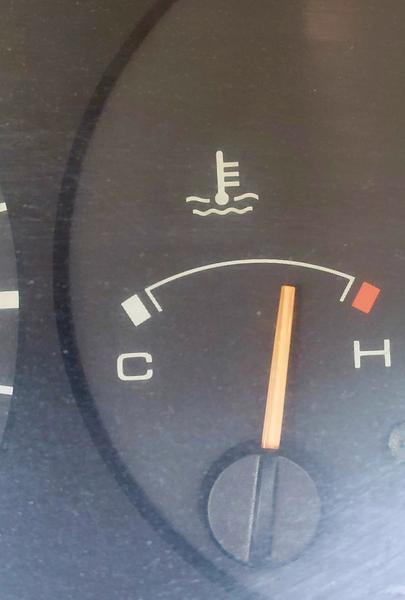

I have now installed this new sensor, you can see the change, now the fan turns on much earlier, as in the picture:
While before the fan turned on here:
I also noticed that now the fan works for less time to cool than in the previous situation

So does this sensor trigger low speed mode directly?
The needle still seems a bit too much to the right, at least from my experience with a 4-cylinder engine the normal temperature is just veeery little to the right side: gallery2.php?g2_itemId=7431
Maybe someone with a V6 engine can confirm...
Otherwise it looks like the fan is still fighting a bad cooling circuit to me(?)
