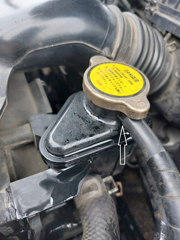

Beitragvon JokeCro » Di 3. Okt 2023, 18:34
So, the container leaks in this place where it is marked in the photo, exactly that place.
I had wiped the container and dried it with a hair dryer, then I pressed the rubber tube located on the opposite side and saw that exactly at that place the coolant was coming out. As if it were a vessel

Beitragvon jwbehrendt » Di 3. Okt 2023, 21:15
Well, as far as I see, is the connection with the return tube leaky.
So if the tube connector itself isn't defective, fix it with a Ty-Rap or a hose clamp.
It would be reasonable, to change the tube to the drain tank; it's almost gone unflexible after about 30 years. A good replacement should be a silicon tube.
Be careful, not to break the return hose connector!
so long, John
P.S. I didn't got a couple of years ago the broken off tube connector fixed, so I had to purchase a new separator tank for about EUR 170.

The container leaks just at the part where the tip of the indicator is located. So the coolant comes out of the plastic

Beitragvon jwbehrendt » Do 5. Okt 2023, 22:47
Well, if You are shure about it, You need to replace the Separator-Tank, I'm afraid.
You may try, to fix the Problem by glueing, but I don't believe it*l be successful.

Beitragvon Kampfkuchen » Do 5. Okt 2023, 23:45
Most plastics are well glueable, but you need to know which glue you have to use.
I'm a bit confused about your description where it is leaking... So the tip of the surge tank has NO pressure on it! The filler cap has a pressure-valve, it opens at 0.9 bar and the water can flow in the tank. So most of the time this part of the tank doesn't have pressure and it shouldn't leaking, even if there's a crack.
Can see exactly where it is leaking? Is it a guess that it's leaking from that tip? Maybe the hose is too loose?
Beitragvon commander_keen » Fr 6. Okt 2023, 13:32
I'll try a translation: So wie ich ihn verstanden habe, hatte er alles ab und getrocknet. Dann hat er den Anschluss (der den Schlauch aufnimmt) und Tank zusammengedrückt und Wasser kam "aus der Plastik" zwischen/bei Tank und Anschluss (da man Plastik nicht auswringen kann, sah er dadurch einen Riss in der Plastik begründet)
Beitragvon jwbehrendt » Sa 7. Okt 2023, 01:06
Naja, dieser Anschluss war ja u.a. mein Verdacht, ich hatte damals erfolglos versucht, diesen anzukleben, auch mit Rohreinlage erfolglos.
Klar, wenn dieser Anschluss nicht gebrochen ist, geht man erstmal davon aus, dass der Schlauch sich verhärtet hat & fixiert ihn mit einem Kabelbinder oder einer Schlauchschelle.
Geklebt hab' ich damals mit einem Loctite 2K-Kleber, der temperaturbeständig und elastisch war.
Dass der Behälter selbst gebrochen ist, ist mir persönlich noch nicht vorgekommen, ansonsten hab' ich fast alles durch.
So, wie ich ihn verstehe, beharrt er darauf, dass der Behälter selbst einen Riss hat, weswegen ich einen Austausch empfohlen habe.
