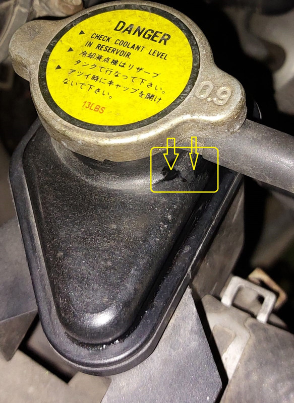

Kampfkuchen hat geschrieben:Most plastics are well glueable, but you need to know which glue you have to use.
I'm a bit confused about your description where it is leaking... So the tip of the surge tank has NO pressure on it! The filler cap has a pressure-valve, it opens at 0.9 bar and the water can flow in the tank. So most of the time this part of the tank doesn't have pressure and it shouldn't leaking, even if there's a crack.
Can see exactly where it is leaking? Is it a guess that it's leaking from that tip? Maybe the hose is too loose?
So, as I wrote before, the liquid comes out THROUGH THE PLASTIC LID OF THE CONTAINER. Through plastic. It does not come out on the hose, nor through the cap. Rather, through plastic. I found another picture and marked with arrows exactly where it releases the liquid.
I managed to find a car dealership in Croatia that can get that container, the price is 200 euros.
I also don't understand, if this happens with the pressure when the engine is running, then why does the fluid come out when the engine is not running?
Just now I went to check and the container is wet, i.e. new fluid came out even though I wiped the container before and the car was not driven
We tried to patch the container with glue and plastic, but without success

JokeCro hat geschrieben:
Because the pressure is not the pressure generated by the water pump. The pressure in the cooling system comes from the heat, as water wants to expand is temperature increases. That's why it still leaks, if you stop the engine but the water is still on temperature.

Beitragvon Kampfkuchen » So 8. Okt 2023, 21:24
Mazda RX-7 SA hat geschrieben:That's why it still leaks, if you stop the engine but the water is still on temperature.
As I understand, he checked it while the engine was not running a long time, so the water should be cold the whole time.
I posted the part number of the tank, you can buy a NEW one for about 85€ all over the internet, why you want to buy a used tank from some wreckers?
Beiträge: 3600

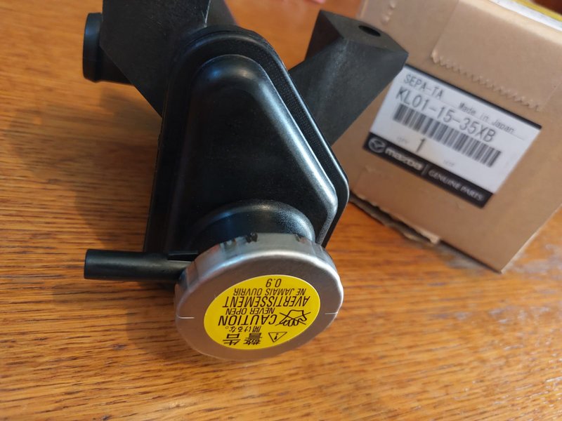

A new container arrived yesterday.
Beiträge: 52
Beitragvon Mazda RX-7 SA » Di 24. Okt 2023, 20:04
Cool!
What you've paid finally?
Beiträge: 1242
Beitragvon JokeCro » Mi 25. Okt 2023, 20:27
Mazda RX-7 SA hat geschrieben:Cool!
200 €
