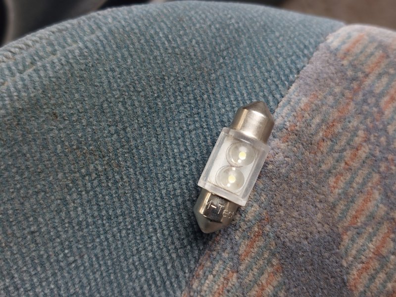

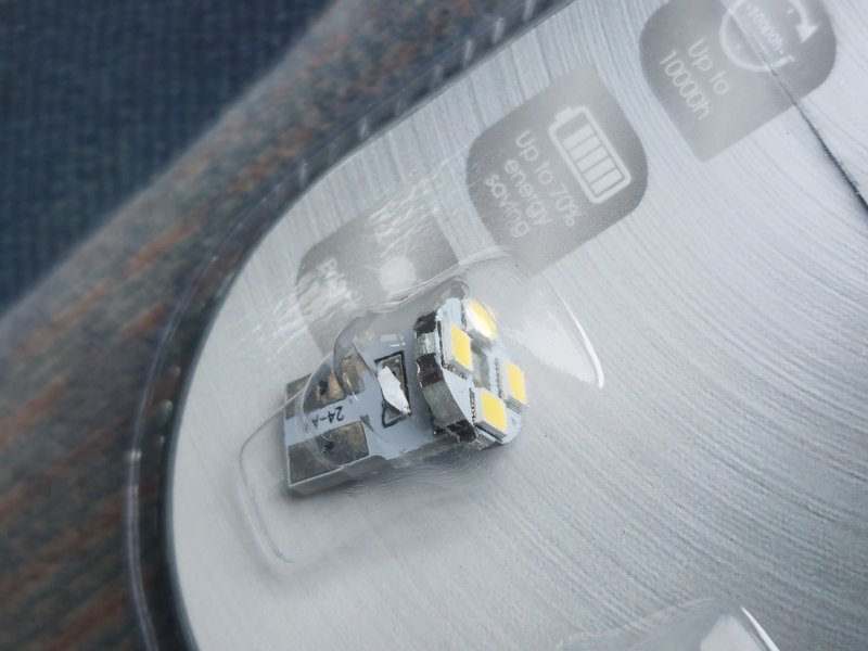

Beitragvon JokeCro » Di 25. Feb 2025, 22:13
The other day I tried it ...
This bulb stays smoldering:
While this one doesn't:

Beitragvon commander_keen » Mi 26. Feb 2025, 15:28
JokeCro hat geschrieben:The other day I tried it ...
Did you try it in both directions? (for me that made a difference with those cheap china LEDs ^^)

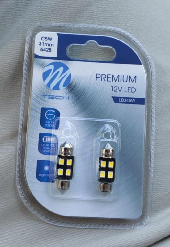

Beitragvon JokeCro » So 2. Mär 2025, 19:24
I tried turning.
I bought these LED bulbs. They don't stay on the smoldering.
First picture above LED
Picture below regular halogen
What do you think and do you have any experience? OSRAM LED W5W 12V 0,8W
I would install these LED w5w for the license plate light
